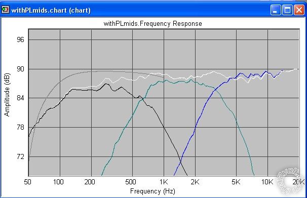

To show how crossovers can alter impedance, here is a network of  two 8 ohm woofers and a  6 ohm tweeter connected through crossovers (although ratings of the drivers are nominal. where each is actually somewhere between 6 and 8 ohms).  The projected output is a fairly flat response:

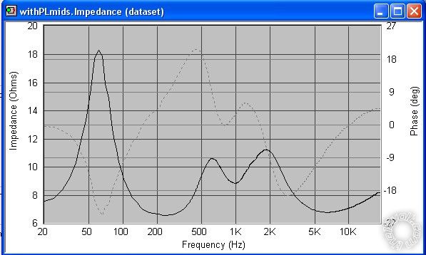

But this next chart shows the varying impedances that the crossovers provoke.  Notice that although these drivers are 8 ohm, the impedance of the network ranges from 6 ohm up to 18 ohms.  Still, this model is considered an 8 ohm (nominal) network and is typical:
