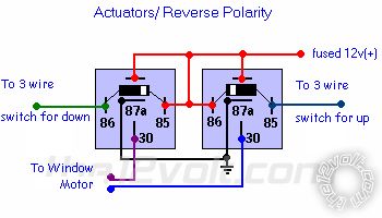

I have a hard time to explain .so I founfd this from apost of Jon 720 (doorlock actuator with remote start)0ct28 ,2009. It is exactly the way I have done it, maybe this will help then you will know how I am looking to put in  diode .sorry if I am dumming out on you but... thanks
neg doorlock output staying on continuos -- posted image.

Platinum - Posts: 13,716
Posted: January 10, 2010 at 10:00 AM / IP Logged
