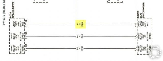

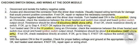

Hi All
I was wondering if anyone has hooked up power seats in an 2005 Chrysler Pacifica to run on an Aux trip from a remote start, from what I can see the Pacifica has a Benz mux type system controling just about everything in the the car. I found some info if anyone would care to take a look at it and see what they think or if it make sense to anyone. It look's to me that I could hook up to the LG/DG wire between the one wire switch and the Door Module, the problem is my understanding of the mux system it looks like I can apply 8k resistance for low heat or 2.4k resistance for high heat. My question is would I apply the resistance thru a hot 12v leg to the mux wire or from a negative thru the resistor to the mux wire, if anyone could help that would be great.

Posted: January 02, 2010 at 10:03 AM / IP Logged
it should be a negative signal

Thanks for the repley,
Do you think there would be any need for a relay or just pass resistor from negtive trip on CM500 (aux 1) to the mux wire with a .5 sec timeout?

Posted: January 02, 2010 at 11:56 AM / IP Logged
relooked it up it a has a relay that cuts the tan blue and conects the lt green with the resistor.
if you want the diagram i got just email me at
weldrite@daktel.com with the subject heated seats 2005

Posted: January 02, 2010 at 6:36 PM / IP Logged
So all I will need to do is flash the resistor between the LG/DG mux wire to ground (neg aux wire) and I should be good to go.
