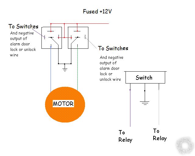

If you can not find any info for the vehicle, it is very easy to use 2 relays and a single switch to get the windows to work.
aussie spec 2006 2006 hyundai accent lc2 -- posted image.
Posted: January 03, 2010 at 2:44 AM / IP Logged
Be careful here, they might use the Mits set-up with the processors attached to the motors. The wiring set up is a right can of worms, data or ground signal at the slave switches etc.
