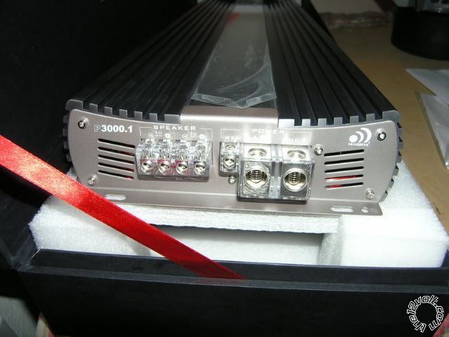

There is only one 2 channel mono amp out there that I know of.  It is actually 2 strapped amps in one heat sink.  In the following picture notice that there are 1 ohm markings on each set of connections.  Notice at the bottom of the connector they are labeled 2 ohm across the outer connectors.  So basically this amp will run 1 ohm per amplifier, or 2 ohms across both amps.   The amp is a Massive Audio P3000,1
mono impedance -- posted image.

Platinum - Posts: 13,726
Posted: January 25, 2010 at 7:42 PM / IP Logged
I have not seen one of those amps in at least a year.  I posted the picture and I got to work this morning and there was one on my bench.  So if you need hep with the Chubby I can take and post more pictures.
