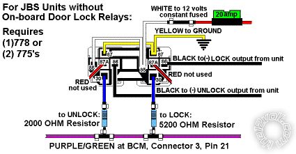

Looked like the internal resistors for lock / unlock were reversed in the xk531. Your best option is to use 5901's lock / unlock outputs to rig up an external relays with proper resistors to hook up to the PURPLE / dk.green wire at c3 pin 21
2002 caravan viper 5901 xk531 door locks -- posted image.

That make total sense, I'm going to try switching the resistors within the xk531 (I have access to surface mount rework equipment).  If that doesn't work I'll rewire using the 5901 door outputs.  I'll post an update once I've tried it
