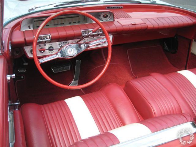

The black thing on the right side of the foot well?
If so I wouldn't do any thing other than put a nice set of component speakers that you can Bi-amp with your 4 channel amp. I think some of the more experienced people on this site would agree unless it is required to have speakers in all locations by your client.
That car was actually made before stereo broadcasting and recording were widespread so the original speaker locations were probably all mono.
