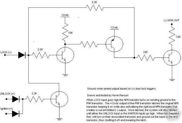

KPierson
Platinum - Posts: 3,527
Joined: April 14, 2005
Location: Ohio, United States
Posted: February 09, 2010 at 9:51 PM / IP Logged
OK, so I have way too much time on my hands.  When I first read this thread I sketched out a drawing of how I thought I could make a gwa output using only transistors and resistors.  Tonight I finally built it, tweaked it a bit, and redid it in paint.  It works great, toggling the output based on (+) actuator triggers.
create a ground when armed -- posted image.
