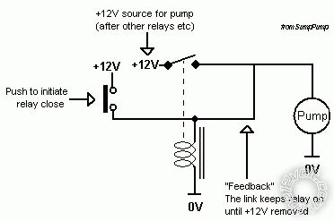

But for the sake of argument, I was also thinking along the lines of a latching relay. (It's a simple circuit that uses and ordinary relay.)

But for the inhibit function, you can use the following circuit where the relay sits between the pump's +12V supply and the pump.
After initial power on, the relay is off until a momentary Normally Open switch - when pushed - supplies +12V to the relay's coil.
The relay then keeps itself on until both +12V sources are removed - ie, the EFI turns off the pump, or ignition off.

(yet again, dwg thanks to izu.)
