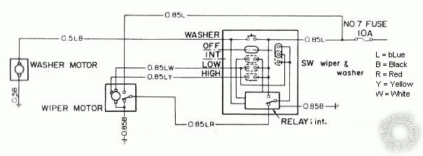

LOL! Gotta love those Japs & their electrics, and Edwards Demming!
An Isuzu diagram of the same vintage is below.
Although it includes a intermittent circuit (which merely applies "Slow" power to get it "unparked" and then the park mechanism takes over), and I think your bLue-Red is its bLue-Yellow, it may be enough to help out.
But I have simpler alternatives (without the intermittent) if needed.
And I can match to you description above.
Typically wipers take 5A; some a bit more.
The 10A power feed (bLue) might be from the battery or the ignition switch - it doesn't matter too much. (If 2 relays are used to buffer switches under 5A etc, the switch can be powered from ignition +12V to inhibit operation without the key - except usually for handy exception of parking - unless you do want to cut power because the arms have frozen etc! But that can be figured out.)
And yes - (Jap) wipers usually have a hot +12V supply and the speeds (brushes) are selected by grounding.
wiper motor, do i need a relay? -- posted image.
(With thanks to an unknown Isuzu source, & EVL1)
