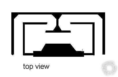

I've had good luck dividing the port up in two and adding additional length to it. That way the sub can sit in the center of the box and each port can fire to each side of the sub. I think it fills the sound more evenly and it looks a lot better to see the sub centered. Here's a old sketch of the basic idea
new box for alpine type r -- posted image.
This is what I do for FUN!

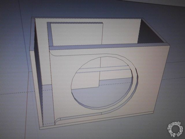

This is Wut Ive got so far..
it should be right at 3 cu ft after bracing total port length of 35 inches (port 2.5 x 18.8 x 35)

Ianarian, I like your symmetrical design, but i simply dont have enough space to get 3 cu ft net volume in that box in my little hatchback.
Maybe Ill try somethin like that after i convince myself that my back seats are un needed new box for alpine type r -- posted image.

WAY to much port area. for 3 cubic foot net you only need 30 square inches of port area. You have 47 there. Also are you figuring your Net right? Total GROSS internal volume minus port, driver displacement and bracing. Im getting 32.2Hz tune if you have correct Net of 3 cu.ft though. If that is a gross of 3 cube your tune will be much higher. Post your measurements and i can double check them, but i can tell you now you don't need that much port area.

Posted: February 07, 2010 at 11:43 PM / IP Logged
28 x 16.75 x 20 (external with double baffle on front)
port length one = 13.5
port length two = 12.75
What is the disadvantage of having too much port area?
