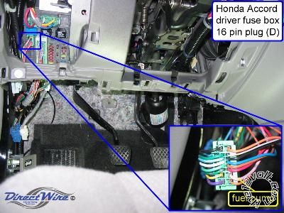

I need to install a fuel kill switch in a 2010 Honda Accord Coupe EX-L.
From what I have seen, the fuel pump wire will be BLACK / YELLOW. Also, there's some confusion as to the location of this wire. Is it in the DKP or is it behind and to the right of the glove box.

Pink (+) - driver dash fuse box, lt. green 16 pin plg, pin 10
09/10 accord coupe fuel pump wire color? -- posted image.
