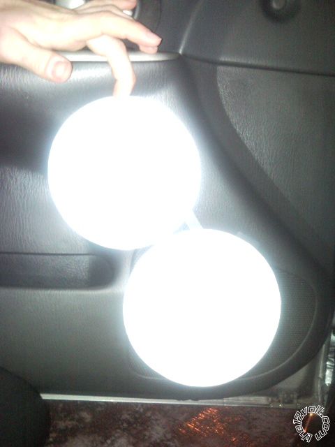

1) Move mid-bass drivers to front doors and make custom door panels for them like concept in pic below with 355 on top of mid-bass.
   QUESTION: Will moving the mid-bass drivers that are getting the rear out signal from the HU be bad in some way and so I should just Y-cable the front outs to all four inputs on my amp? But if I Y-cable the front outs then I have to make X-overs for the mid-bass's? Will this screw with the Auto TA calibration(Manual TA operation available also, just think Auto TA is more accurate)?

Here is the pic. I don't know Why it didn't work.
front, rear hu signal difference? -- posted image.
