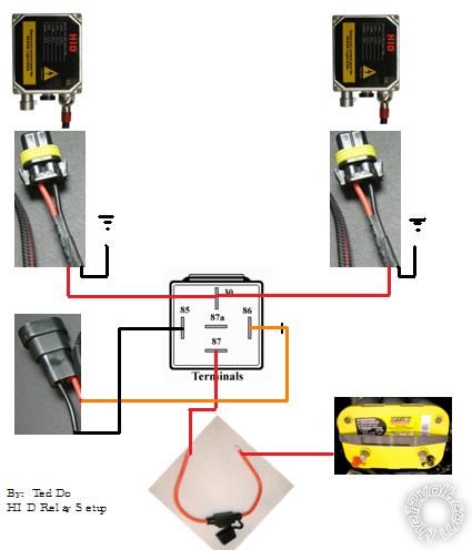

hids? wire it this way.

hids? wire it this way. -- posted image.

this is a simple diagram to indicate how aftermarket hid kits should be wired.
this ensure there is no flicker or strain on the factory electrical system.
place a 1 amp diode across terminals 85 and 86, silver band towards 86.
