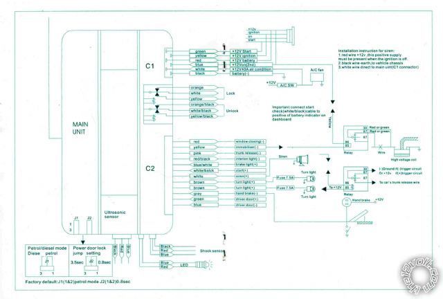

the wiring diagram is below, what i dont understand, is pretty much the immobilser relay connection, they guy said i had to connect the pin 86 of the relay to a constant 12v live,? ive connected it to the acc wire of the ignition,
also with the remote start told i had to connect WHITE/ black- start+ to rpm signal from the injectors? never heard of that before? does any of this sound odd lol, or is it normal ?

the immobilizer part is simply a starter kill.
with your relay.
85 - ground when armed from alarm
86 - ignition 1 on car
cut your starter wire in half
87a - starter wire key side(towards ignition cylinder)
30 - starter wire motor side (towards engine bay)
the WHITE/ blackmust be the tachometer wire. run this to injectors or coil. with your wiring diagram it should tell you where to find tach. remember to test all wires with a DMM (digital multi meter)
