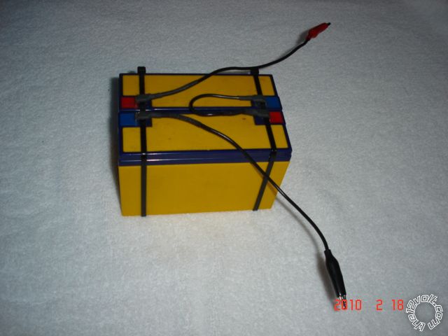

I use two 6 volt sealed lead acid batteries salavged from a UPS system that was used for Personal Computer battery backup.  Hooked up in series they supply 12 volts, have plenty of current and can be recharged.  You can also find these on EBay for about $7 each plus shipping.
test electronics without car battery -- posted image.

Thanks guys. Very helpful. I think im going to go with using a computer power supply. Kreg357, thats a really cool setup you have and i would do it if i didnt have a box full of computer power supplys. Thanks again guys
