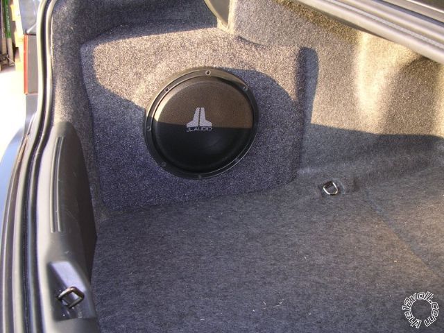

Hi. This is probably a really dumb question but I have never used fiberglass before. I have been wanting to learn and I think this tiny project I have is a simple first step to get familiar with mixing resin. I have a custom fiberglass enclosure that I had built for the corner of my trunk. The car was recently in an accident so I pulled the enclosure while the car is being repaired, I am replacing the sub in it and think I'd like to make sure that it is properly sealed while it's out of the car and not in use. I am almost positive it is, but I am guessing this cant hurt. The front, top, and bottom of the enclosure is MDF, while the rear is fiberglass. What I am reading is that I should be able to mix up a small batch of resin, pour some into the corners/seams of the enclosure, and move the box around so it pools up in there until drying. I should be able to do this again for each seam. Is that all correct? I plan to test this in an old MDF enclosure first before trying it on my fiberglass one.
Also, I probably do not need much for this. Do most local stores sell the resin in smaller amounts or is a gallon the smallest size usually available?
Thanks in advance.

Cool, thanks. I actually went by Lowes last night and they had Elmer's resin by the quart. Didn't buy it as wanted to see what other places had. I am in Florida and close to the water so lots of marine supply places around. Have just always wanted to learn to fiberglass but was either to scared to take on a "real" project or too cheap to risk it failing. I figured I am in no rush here as the car is in the shop, and I have the box out and plan to recarpet it since I am going to be enlarging the hole, this is probably a good way to play around a bit and get a feel for the materials.
That all being said, if you look close at the pic, you'll notice that there's a ring that raises the sub a tiny bit. Sub is fairly deep so assuming they did that to fix a clearance issue behind the driver. I am going to a shallow mount 12" so I am going to need to remove what is left of that ring after enlarging the hole. (going to make sure I can before cutting) If I am not going to be able to remove it, I will then be taking on a "real" project and making a new enclosure for the new sub. Fun Fun
