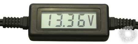

EG - I mounted an LCD voltmeter in my 1980s dash in my 1965 ute.
From this (a great voltmenter from ABR-Sidewinder)...
how to increase ohms by 400%? -- posted image.

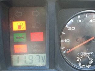

To this....
The only problem being that it isn't backlit. (I have since blanked off the last digit so only 11.9 shows.)
