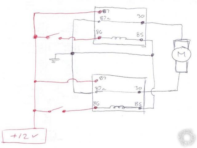

You could also use the DPDT switch to select direction and have a push button to run the motor as another option.
If you must have only two buttons you can do the following. You'll need 2 relays and two momentary push buttons. Don't forget fuses too! (I didn't include them in the diagram)
switch panel -- posted image.
Same as this diagram on the site already.

If I was to use a relay setup like that, will I only need to use one relay? How would you go about wiring it up?
A three way momentary rocker switch sounds like a better option right now, I'll probably go with that instead.
awdeclipse
Copper - Posts: 285
Joined: August 05, 2007
Posted: March 15, 2010 at 11:21 AM / IP Logged
Two relays are required for that setup.
Follow this link
The actuator wires would connect to your motor and then the momentary switches would connect to ground on one side and "alarm lock output" on the diagram, one switch for each side.
sabrev45
Joined: March 12, 2010
Posted: March 15, 2010 at 11:26 AM / IP Logged
Follow this link
Great, thanks for the help. That seems to be exactly what I need.
