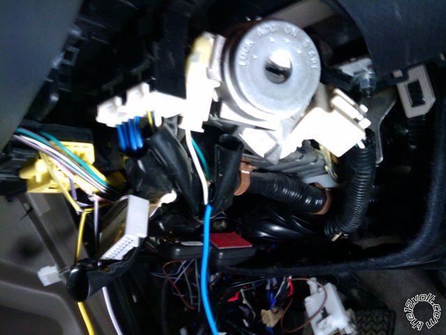

if I post a picture of the ignition area, could you point it out to me?

Posted: March 13, 2010 at 6:53 PM / IP Logged
2005 toyota tacoma pkall -- posted image.

It a black connector with 7 pins in a row.  Pin 3 is empty and Pin4 (RX) is Pink/Green and Pin5 (TX) is Light GREEN/ Red.  Should be on the ignition switch itself.  Sorry, I don't have a picture and couldn't make it out on yours.

looks like a prostart unit?
anyways route the antenna wire and place the antenna on your windshield.
I havnt seen the connector as black, but i have seen it as white on the canadian models.

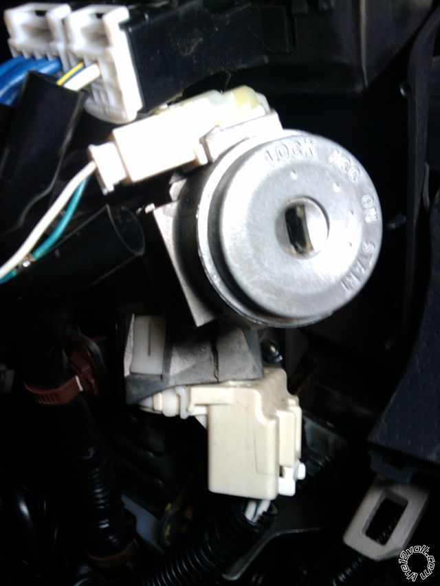

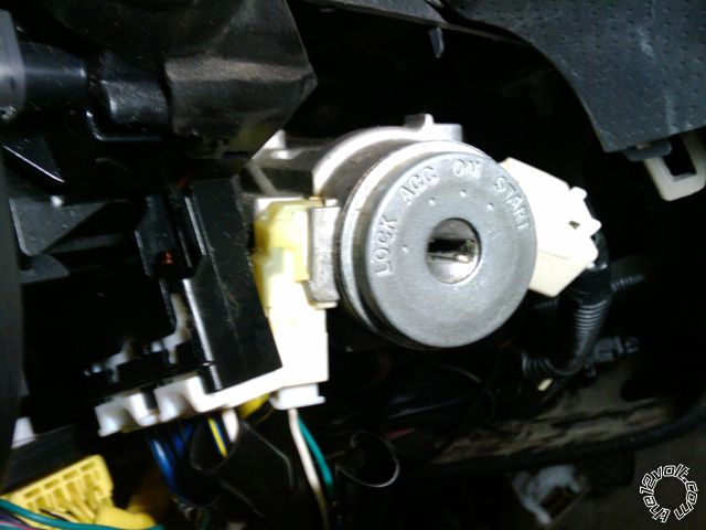

I looked all around the ignition switch and I did not see any 7-pin connectors. I've performed about 10 RS installs so this isn't my first rodeo. I will snap some more detailed photos of the ignition switch. Is it possible that this 2005 Tacoma Access cab doesn't have an immobilizer?

Posted: March 13, 2010 at 7:34 PM / IP Logged

2005 was the first year that the Tacoma got an immobilizer but it is possible that yours does not have one.  What do the keys look like?  Have you tried a remote start without the PKALL?
