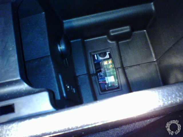

Just a thought, how badly has it been mounted that you can see it?

Oh Howie, always expecting the worse. Actually, I located what I think is the perfect location. On this cars center console, in the storage bin, there is a removable bottom liner. It makes it easier to keep clean I suppose. When you remove the liner, low and behold  there is a rectangular cut out in the bottom of the storage bin. You are looking right down at the floorboard. I removed the console and mounted it directly under the cut out. It is pretty close to dead center of the car. Now all I have to do is lift out the liner if i need to adjust the sensitivity or check the pretty lights. But don't worry, I'll ask some more dumb questions soon. dei 508t field disturbance sensor -- posted image.
Posted: March 18, 2010 at 10:57 AM / IP Logged
WRONG! Now you have to be very careful about any coins, keys or other metallic objects left in there. They will ALL adversely affect it's workings plus of course the metal seat frames. The first choice is always the roof if possible.

I'd never heard of mounting it in the headliner before. Turned upside down I presume? This car has an electric sunroof so I think it is probably not feasible in this install. Seems to work OK where it is, but I'll watch the metallic objects.
