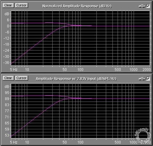

Here's a screenshot of the JBL figures.
lat700 enclosures -- posted image.
This is the normalized response curve, and the 2.83V input efficiency.

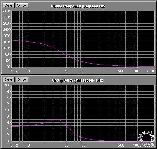

This is the phase response and group delay. Both really nice plots, 90 degrees at 40Hz, and no worse than 7mS, I think it's going to sound really good!
