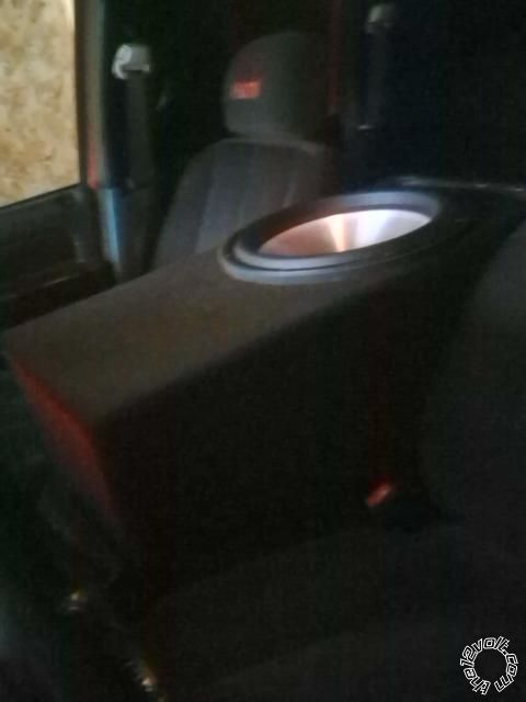

tuning my system -- posted image.
the box is 16" tall, 18" wide, an 33" long
I built it when i attened the installer institute an it came out to b 6 cu ft. I have a feeling the box is way to big for the sub an thats y im having a hard time tuning it. Is there mabye something i can use to pack in the box to take up some of the air space.

16X18X33, assuming you used 3/4" MDF, nets a 4.4 cuft enclosure, which is actually a little smaller than optimum for a Thunder 9500.  If you built the port targeting 33Hz in a 6 cuft enclosure, your actual tuning frequency is more like 38Hz.  Not a huge difference but it means you will have several db less output in the lowest octave from the system and a higher tuning will mean more "boom" in the cabin,

u knw u might be right about it being 4.4 cu ft, cuz when i was desiging it i was going for 6 cu ft but my instructor did kinda copy the dimensions of the box i used to have. any way the way its tuned when im playing a cd,dvd or ipod some songs are louder then others bass wise. would it jus be the songs or the actual tuning its self cuz if its jus the songs then i jus wasted the past 3 months trying to tune this system for no reason.
