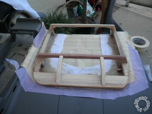

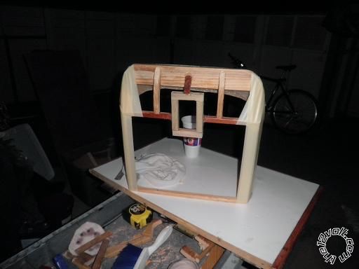

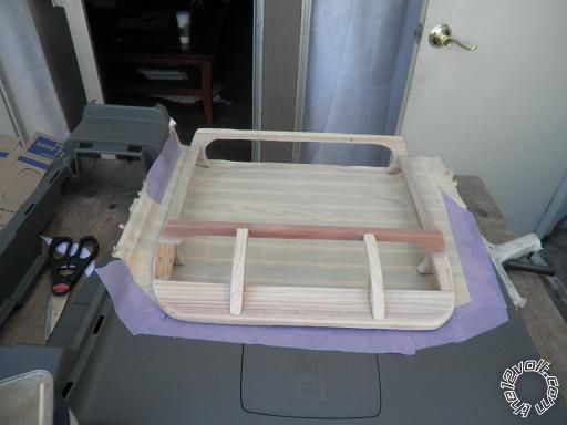

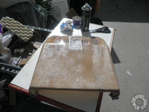

This frame was about as small as I could possibly go. Easy to do too. I set down 1 layer of cloth for a mold of the area that I'm working with.(This is the gap that holds the back seat rest of the back panel in my truck) I set the frame in the one layer mold while wet and added some glass patches to bond the mold and frame together.
amp case, cheap style -- posted image.
After it dried, I had a base and a frame to do with as I please!

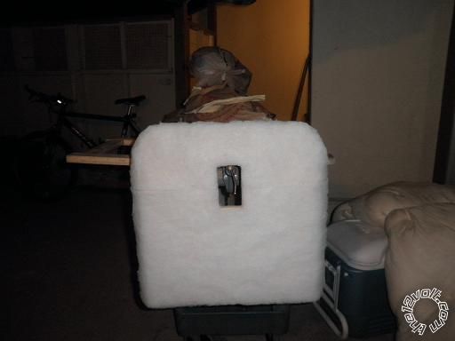

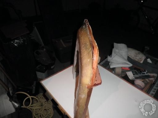

So, I added in the frame for the window. I went with some 3/4x" of some hard wood, cant recall type, but perfect for stapling the tension of the nylon. The other areas that were not going to anchor any staples, were formed just using masking tape. I ended up taping most of the face of the cover to make sure I didnt have any cloth sagging on the corners between the frame ribs. I painted the tape with just the FB liquid first and let it dry.
Cloth? Hmmm Ahh yes, I pulled off the wife beater I was wearing and wrapped that.

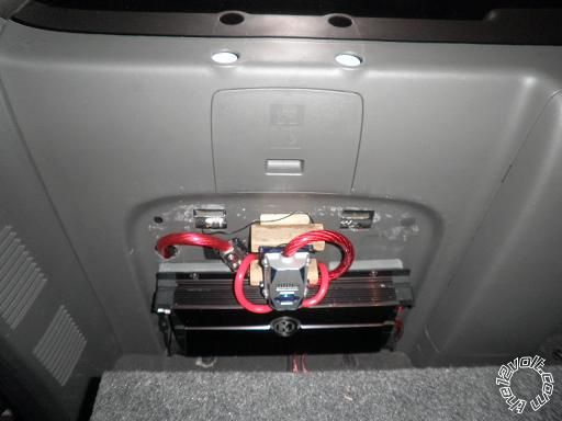

Most of my strength and support came from Bondo. La la la de da!
Post nylon! Is where I be now lads!

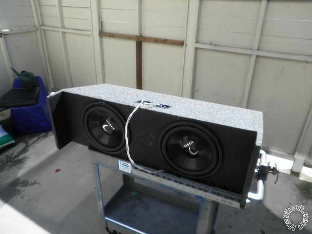

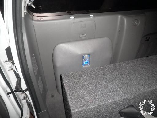

I can find the right color nylon, but the texture is off and it just does not go well with the interior...of MY WORK truck...geez, this stupid thing. Started out simple, just a sub, "I need a little bass". I purposely installed 4ga to limit the amount of equipment I put in. For all my beef I had with Memphis... well ironically I came across a discontinued but brand new amp. Offered to me for free. Could not refuse... Which pretty much means I need a set of subs! My Cerwin VMAX has to take a time out. So I came across these...

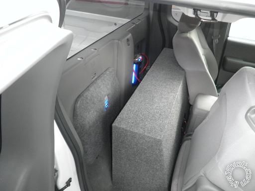

My favorites, D312D4's. Older but bran friggin new!! So we ended up building a downfire enclosure for them. 1.5ft3/sub sealed.. I'm just rockin these for kicks for the moment...there's no way I can keep that size box in there LOL.

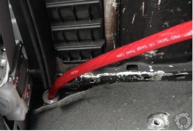

Now I'm on the verge of getting a huge alt. Unfortunately, I have no connections in this area of the business. I had to replace the power wire which was most disappointing...rookie manuever... but now I'm rockin 1/0, of some cable I had sitting around. Which I shall pay tribute too......MTX Thundercable 1/0. I could get a smaller bend radius with 1/2" EMT. Off the hook OFC. Real vitamin C!

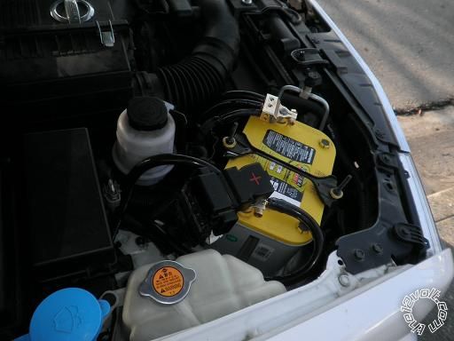

I had to run some stinger 1/0 from the main fuse to the distribution block on the account of the Thundercable not making the bends on the route I had to take. But I locked down my Big 3 with it!

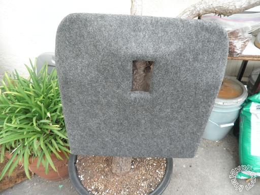

DONE!

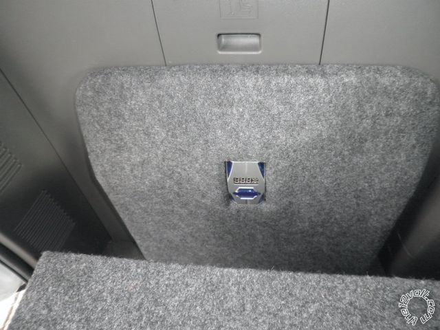

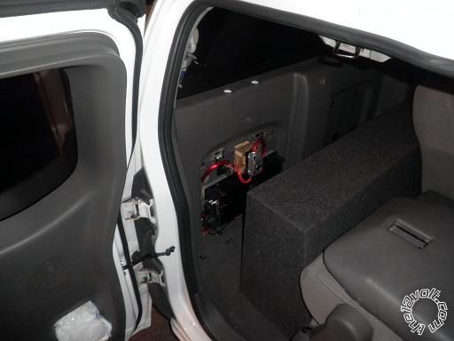

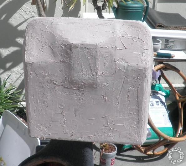

Last night I'm sitting there looking at the amp case thinking: wth is wrong here... then it hit me like a #2.   I was aiming at the wrong match... the box you idiot!( I thought to myself). About a 3 hr setback, but there is no time limit.
I like this a lot better...
I also added a 4f digital cap...made by Phonics Digital.
