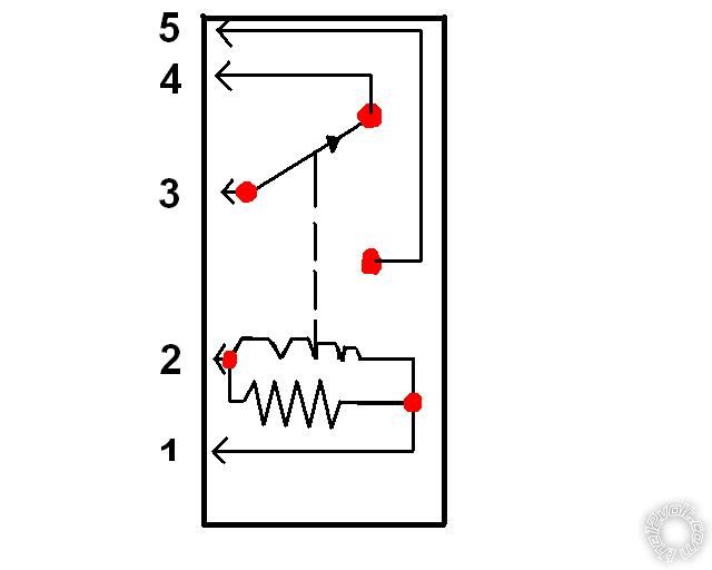

First off sorry for the crappy paint drawing, but thats as good as I could do. Anyway I need help identifying the pins on this relay. (85,86,87,87a,30) Thanks

In the diagram you have however
Pins 1 and 2 would be the coil
pin 3 is common, 4 is normally closed and 5 normally open!

thanks for the reply, but that doesn't help me much. I know about what each pin does, but that is why I drew the picture with the numbers on them hoping someone would say.. 1 = 85 2 = 86, so forth and so on.
Also does it matter if the positive and negative are switched?

Not in this case - you relay uses a resistor across the coil (not a diode to quench the coil spark).

1 = 85
2 = 86
3 = 30
4 =87A
5 = 87
Posted: April 18, 2010 at 12:21 PM / IP Logged
I think that relay is Italian, the convention is pin 1 (85 on the ISO listing) is normally the neg. side of the coil.

I have wired in my relay thanks to all of your help.. Mods can you please lock and/or delete this thread. Thanks
