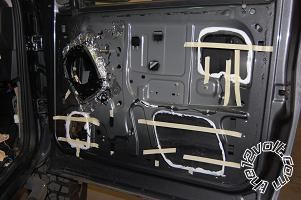

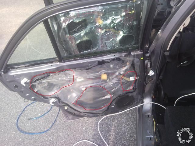

I was wondering what the best way/ways to patch the factory holes in your doors is/are.
patching those holes in your door -- posted image.
I was thinking fiberglass? Anyone know of something better?
I'm not looking to make a sealed enclosure I just want a solid surface to Dynamat. I also know that Dynamat makes Dynaplate which they say is for this purpose but I've never seen anyone use it so if you have let me know.
Thanks

Now i'm gunna sound like a dick patching those holes in your door -- posted image. and not do any of them because i found some 1" thick blue insulation foam board in my garage.
I would do the Plexiglas but I have no money right now and my doors have 4 of those service holes in them and two of them have not one flat point around them. so i figured this foam board is perfect because i can carve it with a knife and my dremel to fit those crazy holes then use caulk around it AND its insulation!
Thanks a lot for the posts, they helped me brainstormpatching those holes in your door -- posted image.
