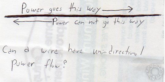

Is there such a product?
power one way, but not the other? -- posted image.
".....um, is that wire hot?"
Platinum - Posts: 13,725
Posted: April 20, 2010 at 7:54 PM / IP Logged
A diode will do this.  How much current capacity do you need?

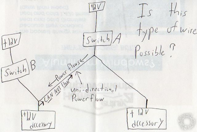

It's for LED's in my headliner. I want the LED's to go on with the dome light and also with a switch.
Posted: April 20, 2010 at 8:03 PM / IP Logged
https://www.the12volt.com/diodes/diodes.asp
I have no idea how many LEDs you have, but a 1n4004 diode will handle 1 amp of current.  Radio Shack sells this device.
