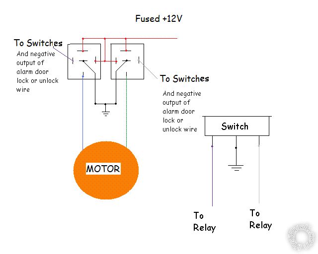

I folowed the wires and they're connected to a relay with 5 pins Excactly like this picture.
i descibe where the wires are connected too .

98 civic, door lock wiring issues -- posted image.
Posted: April 26, 2010 at 5:10 PM / IP Logged
Leave what you have in, that relay you imaged should be either blue or grey from the pin layout, it's Italian and it's a dedicated dual relay with a 3 sec coil shutdown. try grounding either the white or the brown lead coming from that relay after making after making sure it has live and ground. that should work your existing motors. That white and brown will; then go to your existing alarm's neg lock and unlock wires. You should also be able to work by locks by turning the key in either front door.

The first diagram shows 2 relays but it has only one.
I will ground the white blind wire to see what happens.

Your motors have microswitches in them, when you turn the key it pushes down the shaft part of the motor which activates the microswitch switching either brown or white to ground. This then activates the relay unit which activates the other solenoid (or actuator or motor all mean the same thing). Grounding either brown or white will do the same thing.
