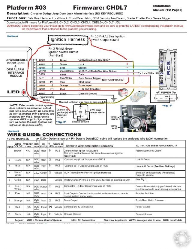

I have an 05 Dodge Durango, no transponder key, just the plain key, and installed a Commando KE-30 with a xpresskit XK03 bypass. I am only doing keyless entry (after resoldering the battery clips on the factory key fobs a couple times, they don't work anymore). I attached a schematic of how I did the wiring. Since there is no remote starter, I had to improvise some of the connections. The problem is that the XK03 will not program when I start the engine. The LED stays on. There is no MUX (2nd Start) that I can find, and for the activation input (GWR) I have tried both the run-Start and Off-Run-Start. Any suggestions on how to get the XK03 to talk to the car? 05 durango and xk03 -- posted image.

I see a couple of potential things here:
1. The activation input only wants to see a ground when a remote starter is engaged. Since you said you have only an alarm and no remote starter, the activation input should not be needed.
I would take that brown activation wire and disconnect it from everything.
If the brown wire "thinks" the remote starter is activated, the module probably won't go into programming.
2. The 2004-up Durango does have a MUX wire. However, I think that with no remote start being installed, you probably don't need it....try programming without it.
If you do end up needing it to get into programming, the MUX wire is in the plug that goes to the ignition switch....it's roughly under where the turn signal lever is (on the driver's side of the steering column.)
You can just barely kinda see the lower edge of the ignition plug even with the steering column cover in place...you may or may not want to remove the cover to make access easier.
The plug should have blue/red (constant) pink/white (ignition) yellow (starter) PURPLE / orange (ground) and PURPLE / black (mux).
NOTE: There is another PURPLE / black wire running all the way down the steering column, but it is NOT the correct wire. The real MUX wire exits the ignition switch, and then runs upward somewhere else in the steering column.
3. Did I just say that the starter wire in the car is yellow? OK, maybe it's pink/blue like your guide says....I forget.
Anyway, if you do connect the XK03's pink wire to anything in the car, make sure it's a starter wire by testing it.
IN SUMMARY:
The brown wire is not supposed to see ground unless a remote starter (which you don't have) is turned on. And when the module "thinks" the remote starter is on, you probably won't be able to program it.
Therefore, I'd start with #1 and cut that brown wire.
#s 2 and 3 above are part of a properly installed remote starter system, but my guess is that neither connection will be necessary in your case.
It's slightly possible that #3 (the XK03's starter input) is required for programming.

Thanks for the suggestions. Before I posted this tried everything, checked everything, and still no luck. I even got another XK03 in case it wasn't programmed.
Based on your suggestion, I disconnected the brown wire (activation input), and it still did not program.
I checked again, and there is no purple /brown, but there is a violet/tan wire. I have the factory wiring diagrams, and its a key sense wire, not a MUX. The factory wiring diagrams do not even list purple as a possible wire color. There is a violet/brown switch MUX, but its to the switches on the steering wheel, so it does not go to the ignition harness.
I have verified that the pink wire goes to the starter.
Any other suggestions would be greatly appreciated.

Based on the lack of replies, it seems that the XK03 is not compatible with the 2nd Gen Durango. Does anyone know of a box that really does work?
My concern is that the CAN bus has both a + and - wire, but the XK03 only ties into the +. Does anyone know if that could be the problem? Is the - only a ground?
Any help would be appreciated.
I think you've found your problem. (-) on a data bus typically is not ground.
