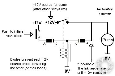

The latching-relay bit can be done simply with something like...
fog light circuit vw 53b -- posted image.
Not that that is a good diagram or description - I just took it from my reply at How to hook up extra battery
... where the "Pump" is the load (lights) and the Feedback arm has a normally closed switch which is pushed open to turn off the load.
Other diagrams are available, but only one person responded to my invite so they have not been made public.
Food for thought?

Indeed, I think I get it... however, how is the relay "pushed" open?  That's kinda puzzling me :)
Also, as I have only one switch for two "operations" do I wire this circuit up in a similar manner to the one I posted above?  I'll have a play later and do some jiggery pokery on SmartDraw.

As to my "latching" relay diagram, to release the relay, either cut power to the circuit though normally one would insert a normally closed switch in the output-feedback arm which is pushed open to break the solenoid power.
Hence 2 momentary buttons - the NO for on, the NC for off.
In many installations, a low voltage cutout is added to the feedback line to guard against batter discharge (when powering PCs, fridges, sound systems etc).
As I said, it's not a good diagram. I have a request to the original author for its and another modification.....
