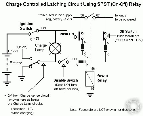

You could even include a low voltage cutout (aka Battery Protector - like the MW728 ~$20) to disconnect the HU if you forget to turn it of, although in that case, maybe a self-latching circuit is better - a push-button to turn on, and another to turn off - similar to the following.... (Though this diagram includes the voltage/charge sensing inter-battery or load connection... The latching part is the Push-On & Push-Off RHS of the diagram. An MW728 output is used to supply the +12V fr the Push-Off leg.)
key off system power -- posted image.
