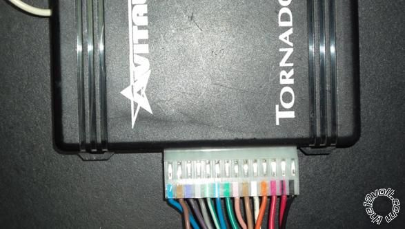

Somebody can helpme to find to wiring manual for the car alarm Avital Tornado...? (The only manual in the WWW it`s for the model Tornado2..!!) avital tornado -- posted image. avital tornado -- posted image.

I attach an image for the wires. I read the Avital Tornado2 manual and some cables ares the same colors, but some cables change in color or dosen`t appear in the Tornado2 manual.
Do U need another picture from the wires...?
Regardsavital tornado -- posted image.

No, that one was good..   ok I can make out most of the colors, i will read them across from right to left
Black   --   Ground
RED / blk  --
Red  ===  12 volts
orange  ===  starter kill relay  ground when armed
white  ====   Parking light  +
Tan  ===
Pink  ===   Ignition
Green  ===
Blue/white  ===    Door lock
GREEN / WHITE  ===  Door unlock
Grey  ===
Violet  ===
Blue  ===
Ok   please let me know if I have the colors right and I will have the for sure wire verifications for you tomorrow...  These are the one I know are for sure..   I want to say green is door trigger, grey is to the led,  violet is for the siren, brown is for the valet and blue is either a instant trigger or a channel 2..  I will have the for sure for you by  tomorrow afternoon, just tell me that I have the colors right
