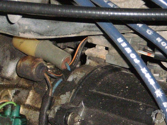

Is it any of the wires in these pictures? (Pardon the grease)
tach wire to coil, 90 camry 2.0 -- posted image.

I'm kind of thinking it goes to the blue wire. Only because in the instruction sheet, it shows one of those little contraptions as being the tach drive. Still hoping someone can verify it. I suppose I could look at a dash wiring diagram from a Camry that has a tach, and follow that wire through the diagram to where it connects under the hood.

Got it! It was the blue wire in the pictures. It's the tach drive wire, used for mechanics to hook up tachs for engine tests. I just spliced into it. Everything turned out fine. It took longer to find the diagram that showed it than to hook it up.

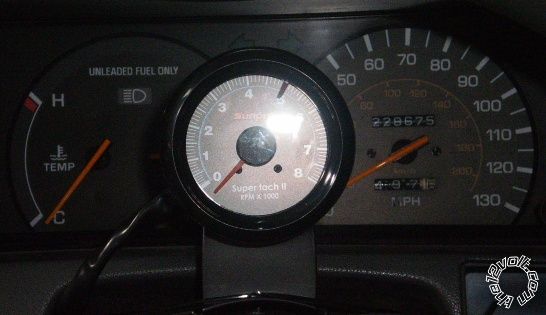

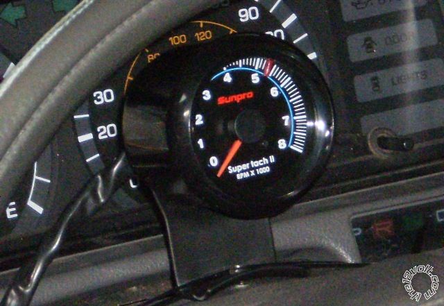

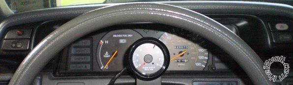

The only logical place I could find to mount my new tach...
