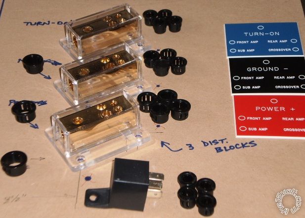

I hate to say this, but I VERY MUCH disagree with you, Kevin. If you ask ANY reputable installer, or even ask Crutchfield, or look it up in any MECP Study Guide, and you will see how bad of an idea it is to hook up more than one item (ANY ITEM) to your deck's turn-on lead. I'd love to see it in writing where you learned it's okay. But hey, it's your deck and your car, but I'll bet you haven't done this to any customers' cars. It's just common sense and common knowledge. I've also never heard of fusing the turn-on lead from any deck. I fuse everything coming off the relay, but never have fused the turn-on lead since it's such a low voltage and it's in a wire loom (if done right).
So if your way works for you, that's great! But to advise someone else that they can hook up as many things as they want to their deck's turn-on lead without a relay is not a good way to make friends after they fry something.
We all do things differently, and I'll admit I tend to do what I have NEVER seen ANYONE do: I tend to use a SEPARATE distribution block for EACH amp. Call me weird (you won't be the first). But I have used a distribution block for POWER, GROUND, and TURN-ON leads. Why? Because I wanted to be different. And because I could run ONE ground wire from ground to block A, ONE power wire from fuse block to block B, and one Turn-On lead from relay to block C. It makes for a neater install and looks cool, but otherwise it even saves on length of each wire to each powered item.
So, since I don't agree with your theory on relays, I figured I would give you something to laugh about or not agree with about me.
1 Remote Wire to 2 Amps? -- posted image.
