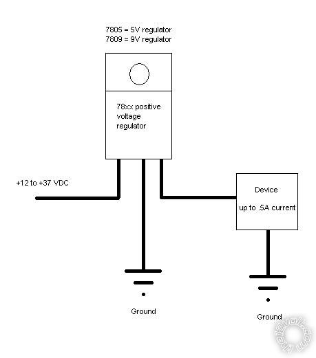

Simple three-pin 78xx voltage regulators is a perfect method to do what you need, AND you will be able to power them both, easily, through the trunk pin.
They are SIMPLE to wire, need no heat-sink up to about .5A, and you'll wonder how you ever got along without them! LOL They are small enough that you can probably even get them IN THE CASES of your projects, then all you have to do is wire the switched 12 volts right to the project box!
how to convert volts into amps - Page 2 -- posted image.
Easy peasy. Don't make it any more difficult on yourself than you have to! For less than $10, plus time, you are done.
Now why didnt I think of that?  :D
He can run the 12v in the project housing through a 1A fuse, and pwr both ICs at the same time. All the grounds go together, and the + output for each goes to the center pin of the connectors he buys.
He can use a single pole rocker switch at the 12v side to pwr on both ICs. The whole thing will be in a case the size of a tin of Altoids.

You can get your 12V source from anywhere. ADD A FUSE before the regulator(s), and as long as the fuse you add is a smaller current value than the circuit you tap in the fuse block/panel then you're golden. As mentioned, a 1A would very likely be plenty, and would easily pop before the "smallest" 3A in your fuse box.
