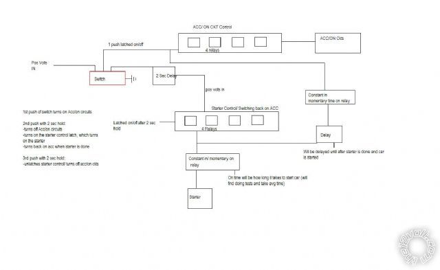

keyless push button start -- posted image.
I want to do a keyless push button start in my car I drew up this diagram, please let me know if this will work or if I am way off by trying to do it like this

Can't make out your wording in the diagram, but relays really aren't the way to go for this purpose! Maybe one of the wiser heads on this like Kevin Pierson would shed some light for you!

buy KP's ignition push start system.
its cool stuff.

I thought it was my age that I couldn't read it! Nice to know the terrible twins having the same problem. If the vehicle has a transponder, you'll need a by-pass contact Kevin Pierson, he's the man.
