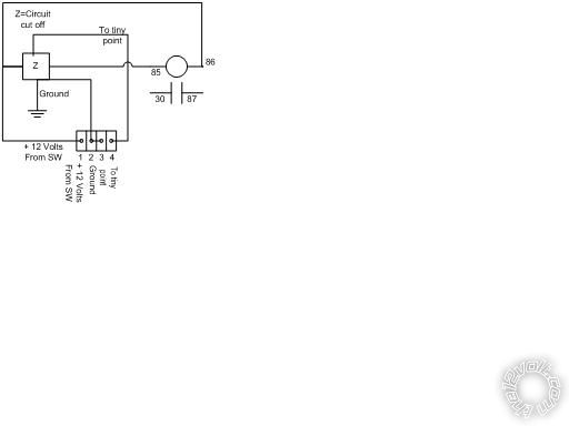

Hello all,
I saw in the car of a friend installed a circuit current cut off of 12 volts and you cannot turn on your car but and this circuit is activated by touch.
You just have to touch where you hid the two tiny points of activation and the circuit is reset giving the 12 volts to re-start your car.
I wonder if someone on this board knows anything about this or have information you would like to share.
To which I thank you very much and would like to build it and then install it on my carts.
I saw the circuit and this is how I look. Hope this helps.
Thanks again
Tabaccoy2k circuit cut off -- posted image.

So a fly lands and the circuit starts an already started vehicle?
Or kills it?
And that's what you want?

Basically this normally open starter kill relay.
It is very similar to those that are here, but with the difference of the circuit "Z" only touching the hidden points.
30 and 87 is closed and you can start it.
The circuit is here you have to use a button or an external signal.
What I'm looking for is if anyone knows how to make this circuit “Z”.
I think it is safer and practical to activate.
Thanks again

In terms of starter kill - ie, a circuit that breaks the starter motor signal - I can almost guarantee their uselessness.
There are very few cars where that cannot be overridden with a screwdriver or coin. Some others need a bit of bent metal.
But that is different to ignition & EMS etc immobilisation. (Big difference between OPENING a circuit as opposed to other defeating mechanisms. And in older cars (pre-CAN & pre-chip), opening of circuits is VERY easy to defeat!)
Yes the older cars that didn't have much for electronics were very easy to get around electrical kill circuits. That's why anti-theft devices were mechanical back then.
In terms of modern open-circuiting, nothing has changed - hence why starter disabling is useless (except for joy riders).
Disabling is different. But disconnecting or open circuiting isn't.
As long as that point is understood....
