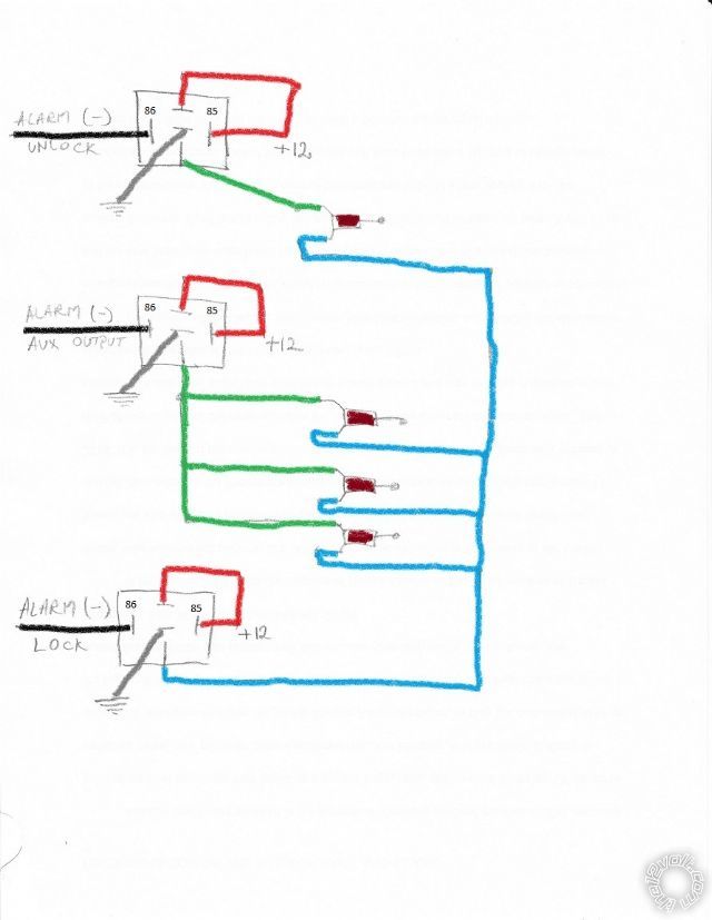

now i was curious on that alarm the unlock and lock outputs are (-) so where do i connect that one on the relays ? to 85 ot 86 and depending on where i will put the outputs than where do i put the diodes ?
i will try to make a small diagram of how i plan to install it and then we can go over how will i put the diode in ...

no howie ... the dealer said that i don't have power doors or windows or seat or anything else in that car. It is the basic of the basic. when i unlock the car i unlock the driver and that's it. if i want to open the other doors i have to unlock them individually by pulling the pin on the doors.
what i said is that i am installing an alarm on my car and that i will install actuators as well and also a trunk solenoid.
I wanted to make a driver priority unlock, but that is on another thread and that is on the past. I will install driver priority or two stage using another auxiliary output, im good with that.
now based on my drawing can u please tell me where and what direction should i put the diodes?

Thank the powers your diagramme is spot on!
I don't have to do yet another diode use in a car alarm -- posted image. .
On a minor note a combined fuse of 30 amps for all the reds, i.e. the constants going to 86 and 87, use that to feed the trunk solenoid relay as well since they won't be used at the same time.
One small point, the international numbering system makes 86 the coil pos. not 85. It won't effect what you do but the car manufacturers do it that way, so what ever side, 86 or 85 you send the 12 volt+ constant to place the diode between 85 and 86, soldered to the base of the terminal with the band towards the pos side.
Posted: July 01, 2010 at 2:11 AM / IP Logged
For more info on above, go to the relay section on this site, go to "add auto lock and unlock" and look at the right hand relay, it shows the diode polarity and position.
