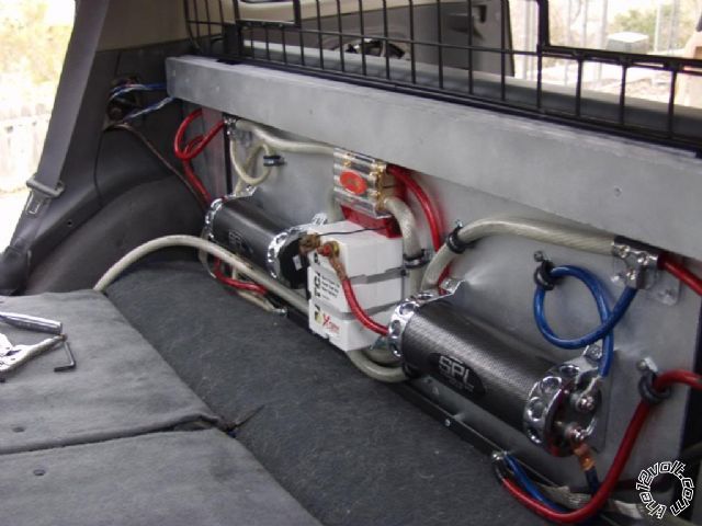

big 3 + some (in addition to stock wiring)
0G wire from Alt to batt (optima yellow top), 0G from batt to stinger SPD4AGU fuse block/voltmeter input #1
2G wire to battcap 400 input #2
0G wire from output #1 to "T" junction #1
2G wire to 3f cap to "T" junction #1, 2G to Amp from "T" junction #1
0G wire from output #1 to "T" junction #2
2G wire to 3f cap to "T" junction #2, 2G to Amp from "T" junction #2
(yes I need to finish running 0G to amps but I ran out of 0G and don't have any 0 awg to 4 awg terminals)

Your ground wires should at least equal the capacity of your power cables. For cranking, ensure a good battery- to engine ground cable.
Have you checked the condition (open circuit voltage) of the Optima and BattCap? (After sitting a while.)
Maybe start by disconnecting the BattCap in case that's failed (it's merely a battery) - that might be draining the system. [Does it get hot? (LOL!)]
As to a bigger alternator - the alternator needs to replace the power used by your systems, plus a bit more for battery inefficiency.
The best guide is an (in dash) voltmeter (across the battery - not the ignition).
And since you are already running dual batteries, why not move the yellow top to the amps (where it should be) and use a normal battery for cranking etc. (Having a low-ESR battery (ie, AGMs, like Optima etc) remote from the BIG load defeats much of its capability.)
And consider battery isolation - especially if it turns out the BattCap or Optima have damaged each other.

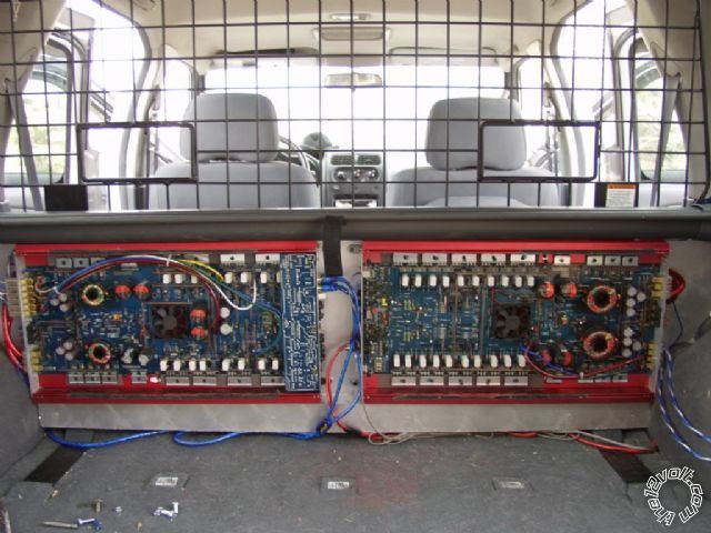

"Crank it" meaning volume...? too much amp draw visonik v6611 and v3909 -- posted image.

To keep it like KISS, ya know....  I would upgrade from that sorry Visonik to a real amplifier and start all over again.  I, too, have spent furious hours trying to make a poor amp work like a pro.  It's not worth it.
And , of course while you're starting from the beginning again, read those grounds as DYohn has advised.
