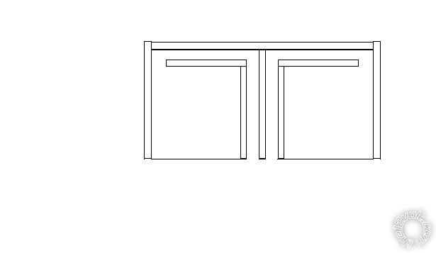

need a tried and proven ported box design -- posted image.
here is an idea of what the top view of the box could look like with each speaker having its own port.
Boosh
icearrow6
Copper - Posts: 497
Joined: February 02, 2009
Posted: August 26, 2010 at 3:45 PM / IP Logged
Check out This tech sheet from kicker. Nice graphical layout of the expected output based on the ported design. Look it over and decide what will work for you.

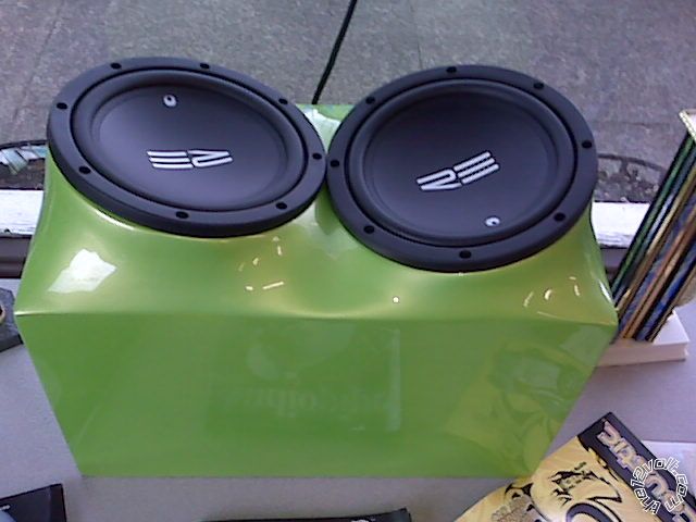

i have done speaker boxes for 17 years, i plug the infromation in to my program then play with it per rig/ need of my customers. sometimes they are on w/ manf specs, but truth is after some brake in time the t/s change anyhow. what ride how much power and what do you listen to?
need a tried and proven ported box design -- posted image.need a tried and proven ported box design -- posted image.

Posted: August 27, 2010 at 2:54 PM / IP Logged
wow way bigger than it i thought is was ganna come out! can i edit that? can find edit tab
