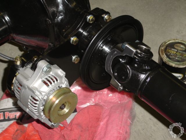

I just want to take a moment to thank all you people for having this forum. It has been a great resource for me and I really appreciate it. I've been working on this 32 Ford for a while and was having some issues with setting up both the alternator and the batteries. Oldspark was kind enough to be of great assistance to me via email and I want to publically thank him for his teachings and help. I'd have been lost without it. Thanks again.
Jim
Here's a pic of the alternator setup on the chassis. Sorry if I posted this in the wrong area
oldspark thanks -- posted image.
