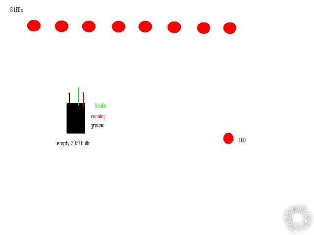

using premade led bulbs would dfeat the purpose of my project. I have made an LED housing, basicalliy redesigned the inside of my tailight.  if anyone can possibly show me how to wire up these leds with graph or pic that would be soooooo awesome.
Heres a pic, again if someone could repost a drawing using this pic or whatever would be a great deal of help. Thanks so much in advance!
connecting led's to 2057 socket/bulb -- posted image.

Your pic didn't post.
But I assume you have the dual intensity figured out?
I/we need that specified as well.
Typically if done with resistors on a single string of LEDs, the brake +12V simply bypasses the (first) resistor (the tail +12V goes thru that resistor).

Thanks for the quick response. I unfortunately dont have the dual intensity figured out at all with the bulb and i have been stressing to get this to work. I am  not completely clear on what you mean with the bypassing, Im a bit  more of a visual leaner. I am trying to learn the best i can though.  When i recently tried, as seen in the pictures, when the running lights were on they all turned on, but when i applied my brakes, they all shut off.  however it did work when i used a single source on my battery.  when i touched one end with the resistor it was dimmed, and without the resistor in the way it all brightened ( i guess thats bypassing?) I am very puzzled why it wouldn't work with the bulb,
here is another upload attempt of the pic
[connecting led's to 2057 socket/bulb -- posted image.

Well let us know when you figure out how you change the intensity, and how many LEDs you will use.
Having tail lights on with EITHER brake or running lights but not both means there is no ground connection.
