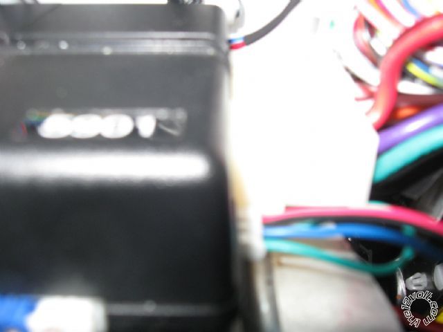

Hello 12Volts friends ,
I am upgrading a 5901 ( from eBay 9/2009 ) . Adding 500t , 504d & 506t .
I include a picture of a 4 pins , on same side and next to H1 connector ( big starter wires ) . Is this that 4pins , the correct MUX port ?
Directed Quick Reference Wiring Guide ( QR5702 2008-08 )  does not show MUX port .
Thank You ...                                             rcavictor .

rcavictor, looks like you bought previous Viper 5901 brain unit. My MUX port location is exactly as described on the diagram i posted on the top of this page.
From your picture is seems like you plugged your sensor connector correctly, green and blue wires are alarm warn away inputs.
Just bear in mind that MUX port provides constant power supply, so your sensor will draw current even when car is not armed.
Here is my setup if its helpful, you actually don't need to separate MUX port inputs with diodes like i did. only if you connecto two or more sensors to one MUX input.

Ok, never mind about diagram of my newer Viper 5901 which has a separate dedicated MUX port.
Your older 5901 brain_unit must be this one:
mux port on a 5901 -- posted image.
And i don't know whether that D2D port (next to H1) can be used as MUX port or not. Maybe some other users will unveil this mystery.
- So it is a Viper 5901 brain unit previous issue .
- Is this MUX port ( previous Viper 5901 brain unit ) to the right of 5901 marking , near H1 ( big starter wire port ) ?
So , if my 5901 does not have any MUX port , I must use H1 blue trunk (-) instant trigger output to my 3 sensor blue wires ... including diodes ...
By now I have tested this 4 pin port (optional sensor port - 4-pin connector) with 506t wiring . Red is 12 volts from 5901 , black is ground ,  blue is (-) alarm trigger ( short ground touch = warning , long touch = alarm ) .
Multitester confirms this 4 pins does like a MUX ...
Thanks for answering, rcavictor.

Posted: September 04, 2010 at 1:02 AM / IP Logged
Thats how i found about my MUX port too, i had to test it myself because i couln't get any answer on the net.
