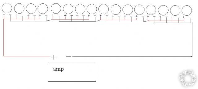

I have a total of 8 sets of Polk db 6 1/2" 4 ohm speakers that's 16 speakers all together my current setup is for the use of 6 sets I'm trying to achieve a 4 ohm load by using either my current 6 sets or all 8 sets how can I get these 12 or 16 4 ohm svc woofers to 4 ohms thank you

Parallel 4 speakes to achieve a 1 ohm load per set.  Do this for the remaining sets of 4.  Then wire each of the 4 speaker sets in series to achieve a 4 ohm load.

multiple speaker wiring options -- posted image.
should look something like this.

can i ask why?  Why would you want to have 16, full range speakers, on one channel of an amplifier.  Maybe i am assuneing too much, but i would guess you are trying to bridge a single 2 ch amp into 4 ohm on this.  You are talking about a potentially a very big amp needed to do this.  Even if you wanted only 50 watts per speaker, you would need a 800watt amp.  that is the only way i can see you getting enough power out of any amp to correctly push all 16 of those speakers on one channel.  What kind of amp is being put on this?
