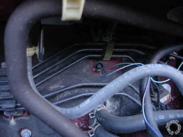

Here is a picture of a 2007 CR-V.  The grommet is high on the firewall and slightly to the drivers side of center ( US car ).
tach wire -- posted image.
Posted: October 18, 2010 at 6:47 AM / IP Logged
OK so that now makes three that we know of!
