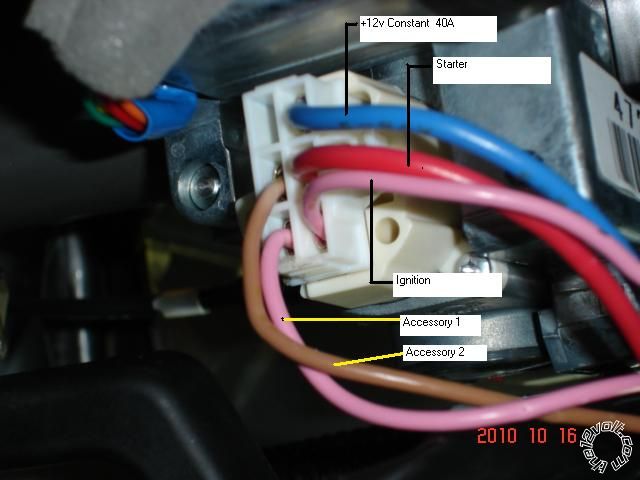

Here is a picture of the ignition connector.  Most Bulldog units have 2 ignitions, one accessory and one starter outputs.  If want to power both accessory wires, an extra 30/40A SPDT relay, fuse holder, 20A fuse and possibly some diodes will be required.
2008 rogue -- posted image.
