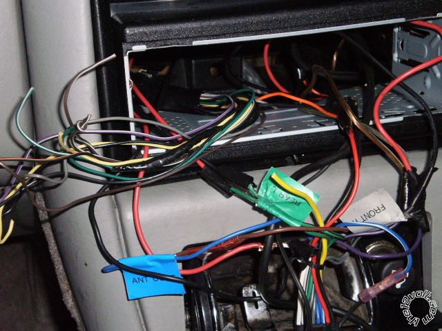

I just purchased my first-ever Cadillac, a 93 Seville (not an STS or SLS) from my brother for $2000. It's a beautiful car and has been very well taken care of, and runs like new! I fell in love with this car after only two quick drives in it (I was originally selling it for him).
Anyway, the aftermarket Kenwood (ironic it's a Kenwood... note my username) stereo was hooked up bad and only 2 speakers worked and the antenna didn't go up. So I decided to remove the deck and OMG!!!, what a mess! In my 35+ years of installing car stereos (not as a pro at any shops though), I've never seen a deck installed as poorly as this one! Not one connector! It was all twisted wires and electrical tape! Heck, I did a better job when I was a teenager!
Needless to say, I decided to check the stereo wiring diagram shown on the12volt's excellent source, plus one other site, and they both show the same diagram:

The problem is: this is NOT correct! Well, mostly. The Power, Ground, and Memory are correct, as are the Right Front and Right Rear speakers (The RR was replaced with a new wire, but the original wires at the speaker are blue and blue/white). But there is no pink wire, no tan wire, no brown wire, and there are 3 gray wires and 3 yellow wires as well as 2 harnesses that each have a red and black wire. (BTW, this card did NOT come with a Bose system.)
I need to figure out the precise wiring for the stereo. I just need mainly the speaker connections and power antenna wire. I have the power, ground, and memory wires figured out. They had the Kenwood's blue/white amp turn-on lead hooked to something but apparently not the right wire, and they blue antenna wire (still labeled) not even hooked up!
Thanks so much! This baby has a nice deck with remote and I want it to work until I upgrade to an even nicer deck. But I get no sound at all to the left channels and no power antenna.
I appreciate any advice or help you can offer. The pic below shows only part of the MESS that I found! The gob of wires hanging out toward the steering column was all cut from a harness, then totally taped up with electrical tape and not one of those wires was connected. I also found 2 looms that both have a red and black wire, but can't figure those out either.
Any help would be GREATLY appreciated! This is a nightmare I don't want to relive ever again! I could get a factory harness from a wrecking yard but it probably won't help to identify all these cut wires. Thank God for ONE thing: I found correct power, ground, and memory wires and RF and RR speaker leads, so I'm getting closer.
93 seville stereo wiring confusion -- posted image.
NOTICE the ONLY connector used? It's for amp turn-on, but not connected properly.

look in the trunk, right side in the area of the power antenna....is there still the amp/tuner module from the factory radio present?  the wiring there should have all the connections you need.  you'd also need to run an extension cable up for the antenna if one hasn't been previously installed.

Yes, there is a big silver box that says Delco on it, connected between the antenna and the body panel.
As for the antenna, there is a regular antenna wire coming out at the deck area with a small (12g or 14g) black wired running along the antenna wire. Is that the antenna up/down wire I need?

it might be the antenna control wire, check in the trunk to see if it connects to the antenna relay.  the relay should have six wires on it.. white, green and grey which lead into the antenna itself and orange, black and yellow? which connect to the car itself.  the yellow? would be the control lead for the antenna... connects to the head unit.
 you didn't say which kenwood unit you had, some don't use the antenna remote out although it is present in the harness.  as for the rest of the wires, assuming you identified and used the ones at the rear, remove any connections and insulate the terminations.
metra does have a harness available which connects to the factory wiring in the trunk and extends forward to the radio opening.  that may be an option if the wiring in the trunk at the tuner amp module is unmolested.

The deck is nothing fancy right now, but will be soon. Right now it's a KDC-MP208. I looked it up and even though it has an ipod jack in front and a remote, it's still a very cheap deck: $75 brand new. It does have a separate blue/white amp turn-on and blue antenna wire. But I'll hold off for now.
I like the idea of buying a harness that goes from the trunk to the deck area. Seems a little easier than figuring out these factory wires. I'll check their site today for an application and part number.
So you're saying that a bunch of those wires in my dash are actually running all the way back to the box next to the antenna? Oh, I did apply voltage to the wire running along the antenna wire but it didn't raise or lower the antenna.
I'm wondering how much of the factory system they fried by hooking it up wrong. So far not the power source/fuse, switched 12v wiring, or ground. But I'm wondering if the box in the trunk is fried. If so, I'll pick up another one. I can't get any sound out of the left speakers, even running a signal from my portable stereo directly to any wires but I was able to get sound out of both front and rears on the right side.

don't worry about the box in the back, it'll be bypassed completely with an aftermarket headunit.  the factory headunit was more of a controller...well cd player or tape deck also. since it's easy to take the trim panel in the back deck that covers the rear speakers, make sure that a speaker is there (left side), and connected also.
metra part number 70-1856 since you didn't mention a bose system. the color codes on the aftermarket harness will even match up to the aftermarket radio....isn't that nice.
