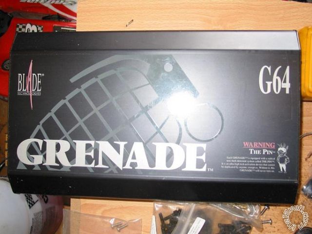

You have a Blade Grenade G5 amplifier. A true dongle, the missing pin was not just a plug-in "thing", with a resistor and a cap inside. My understanding at the time was that it was a chip, encoded to work with that amplifier ONLY. Not the MODEL, but THAT amplifier... The serial number was encoded within the chip, and it will not work with any other amp, nor will any other chip work with the host amplifier.
My understanding was ALSO that it was, like, 64-bit encoded, so as to be (at THAT time, anyway) un-crackable. Neat tech, but that's about all.

blade technoligies amp -- posted image.

As far as I know there is no way to bypass the security dongle.  Perhaps if you were familiar enough with digital electronics you could crack the case and see if the IC functioned to lock out the power supply or the output stage and replace that - but that exercise would only be something a hobbiest might do for fun, not because you actually wanted to try and use the amp.  My best advice os to go back to wherever you "picked it up" and see of the previous owner has the dongle.
