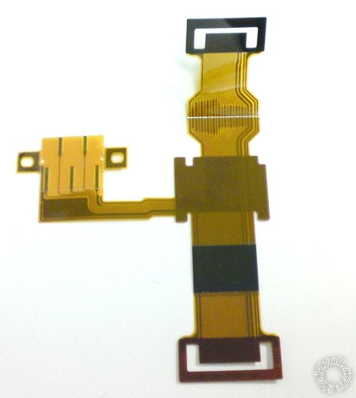

I am not familiar with this particular deck.  But it sounds as though the ribbon cable is failing.  I have replaced many ribbon cables on other Kenwood models.  You can get the part from Pacific Coast Parts.   pacparts.com or 1-800-421-5080.  This is probably nothing you are going to want to change yourself. The part number is J84-0154-15 and it sells for 13.00 plus shipping.  I get between 60 and 80 dollars for the labor portion of the job.
