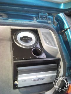

I haven't braced any of the sub boxes that I have built in the past but they were all less than 3 ft3. I think it mainly depends on the specific box you are looking at and if there are any sides that are large enough to require bracing.

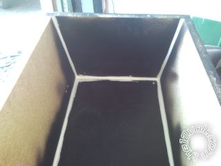

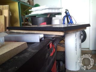

I have built TONS of other random things out of wood and as long as you have good flush joints, GLUED & screwed (or brad nailed or biscuit or pegged) together I can't see any reason to brace a 3 ft3 ported enclosure (I would brace a sealed enclosure this size because of the increased stress(pressure) you would have increased strain (flexing)). I also think it would be a waste to line the inside with resin just use some caulk to make sure the seams are sealed. If you have access to a lot of resin at work or something then you could cover the outside of the box with just resin and sand and paint it but that just be for aesthetics. Fiberglass and resin have almost no rigidity when flat, its the curves and complex shapes that make them strong.

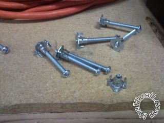

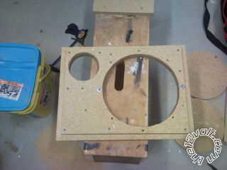

!!! HOWEVER !!! I highly recommend doubling up the baffle or at the very least make a ring to double up around the woofer to give the screws holding the sub something substantial to hold on to. I used Tee Nuts on this box and they worked WAY better than drywall screws.
